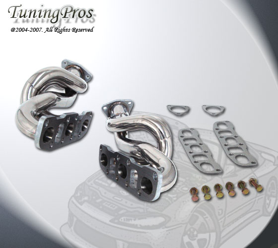

I've actually come across quite a bit of Ebay headers, but I really dont know if there's any fitment issues.. I gotta do the research.
There's a few that I found under 150.00
Here's one of them:

not bad. I would email them and see if they can measure the length of the header from tip to tip. then take that measurement and go under your hood and see where it stops. I imagine they may be a bit too long and might run you into some hard lines that you wont want to mess with. If it stops with decent space then you might be onto something.
For those you have posted looks like you can chop maybe 6" off the end, put a 90 bend (well for the bank closest to the firewall) then route it forward. the bank closest to the front of the car I believe should have more than enough room (especially if you move the battery).
if this setup can work. it will eliminate the need for a forward Y setup, and leave room for a down pipe to be routed thru the same passage that the Y Pipe
edit: now that I think about it. the bank closest to the front of the car, those headers will smash into the fans. unless you go a custom route with the fans I think it wont fit... but I'm just eye ballin it
