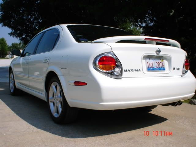

well this past weekend i ended up getting hit by a friend of friends car... giving her the opportunity to get the problem fixed... now i went to bunch of body shops... prices ranging from 2000-3100 for remove and replace quarter panel paint and bumper as well... and prices on repairing existing quarter panel with paint and new bumper is around 800-1600 (two said they'd pop it out and one said heat it up and finish it off)...
i know the body shop is just trying to make money off the repair job even tho everything is computer generated... wat would u do...:

did she hit you with an suv ? that dent is sure up there. at least your smoked side light isnt damaged
i doubt that can be just "popped" out without wrinkles
i would just get her insurance to pay for it, but if she is willing to give you money then do that and get it fixed, you don't want to be driving around with something ugly like that, especialy since you put so much work into your car

definitely get a new panel, you dont want to drive around with the 15 pounds of bondo it would take to make that smooth after popping it out

I'd have the panel replaced. Since the rear quarter is part of the unitized body, it is in effect part of the "frame". Modern cars are made with high tensile strength steel. This is what allows auto manufacturers to use such thin steel (think light weight). However, once they are mashed, the only proper repair is to replace the metal. Heating it up will cause the steel to no longer be of the high tensile strength variety. If the heating it up repair is done, you will have a "soft" section of your frame and that will cause you no end of quirky behaviour from your car. Pounding it out isn't much better. The steel has already been stressed from the impact and is no longer strong along the wrinkles of the damaged area(s).
With damage that significant, I'm surprised there aren't "wrinkles" elsewhere on the car. Have you checked the in the trunk under the carpeting. Make sure there aren't any bulges/waves/wrinkles in the floor. Make sure all the body panel gaps are even - all the way around the car. An impact in the rear like that can show up in the drivers side front fender... It's possible that the rear axle got moved. A check on a frame rack will verify that the car is straight (ie doesn't have a "diamond" in it). If the frame is bent, then the $2k-$3k estimate seems low to me.
Arguably, you should take your car to a reputable collison repair shop and get a professional estimate. Shops that work closely with insurance companies are not necessarily vested in your interest. So it would behoove you to choose a shop that doesn't do work for you insurance company or hers -if for no other reason than to get a second opinion.
When it comes to body repair panels, insist on geniune Nissan parts. There are many other companies that make repair panels. However, most are manufactured with the intent of cutting cost and not with the intent of fitting properly. That is not to say that 3rd party parts won't fit properly. However, genuine Nissan parts come from the same stamping dies that were used to manufacture your car.
(If you really need to obsess about collision repair, check out: http://www.i-car.com/)
I's also second the notion that you get her insurance company to pay for the repair. Also, insist upon getting "dimished value" from the insurance company. This is where the insurance company will pay a lump sum to cover the loss of value to your vehicle. Consider 2 identical Maximas, except one has been in an accident, and repaired. Which one would you want? The damaged and repaired vehicle will be worth less and the difference between the 2 cars is "dimished value".

Remove and Replace the quarter panel and blend the right rear door and deck lid. If you try to pull out a dent that big, it just wont look good in the end, especially since your car is black (black shows dents easily). The quarter panel is not much of a structural piece it is mainly just a piece of sheet metal. The real structure is behind it. You might want to have them check that out as well. Its kinda hard to tell from the pic, but is the bumper damaged?

As far as I can see, you don't have to replace the quarter panel. Someone who knows what he is doing can fix it so that it will look like new... Just make sure there is no damage under the quarter panel.
