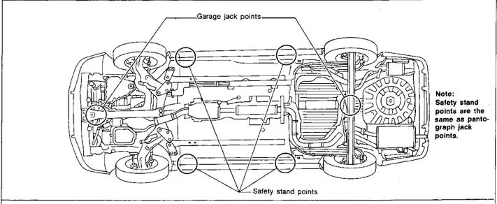

Oh as another sidebar, would any of you be able to tell me where the 'best points' are to place jack stands under the car? I've see where folks have put them basically on the 'rails' where the emergency jack fits. However, I've see those rails being bent as a result.
If it's not obvious, I've been through a couple cars (lemons) over the years. I've got an emotional attachment to this one (besides I'm trying to save a few bucks while learning more about repairs).
Here (PIC from Nissan FSM);
