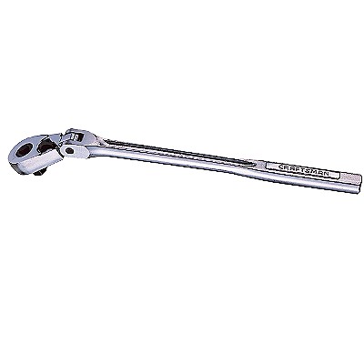

AWSOME!!! found the bolt behind the power steering pump..HAVE TO SAY NISSAN WHY?? ha ha ha..worked on it for 4 hours and cant get it removed..bought two universal joints and extensions (thinner) and still no luck geting the angle i need to take it off..Rats!!

This ratchet just fits up in there with a shallow socket.
Its not easy thats for sure.
