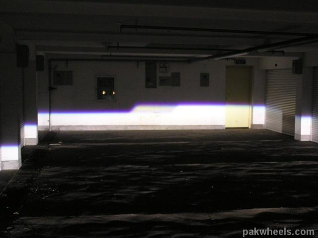

...but projectors dont focus the light straight forward???? you know that right?
they give you a nice wide spread of as even as possible light distribution. with a top cutoff that stops the light from blinding people.
http://www.topgearautosport.com/img/350/1021012ZVZ.jpg these are the headlights your are talking about.

No I didn't know that I don't have projectors. I'll try and post a pic of my beam if anyone is interested. One of the adjusters is busted, so the left beam is off a little.

I know they're far from ideal, but I'm content with them. Against the door you can see the beam distribution or lack there of, but once their on the floor they spread pretty well.
This is with 1.21 gigawatts of power, gotta be careful with this one, can bend time/space.
yea, these photos show exactly why i put the stock headlights back on, gotta wait till i can do a retro
